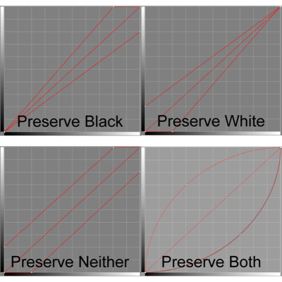

Depending on the Preserve setting, one of four sets of curves are applied to the image as illustrated below:
None of these preserve the black or white points of the image unless they are at pure black or pure white.

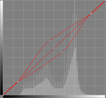

To do what you want, I recommend using Brightness Curve with a curve something like the following:
Brightness Curve.jpg (40.53 KiB) Viewed 2898 times
These curves will make the image lighter or darker without moving the black and white points of the image.
