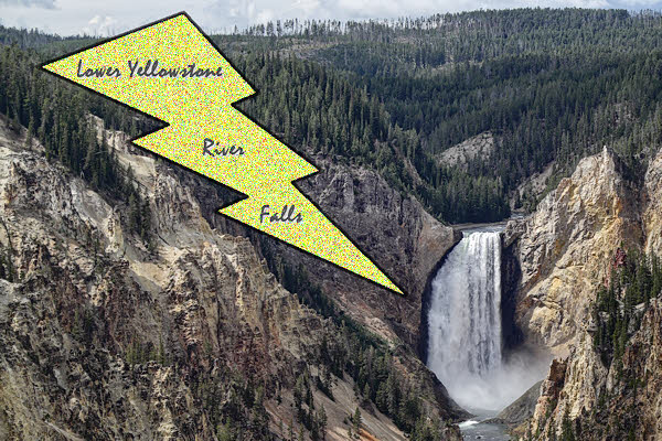

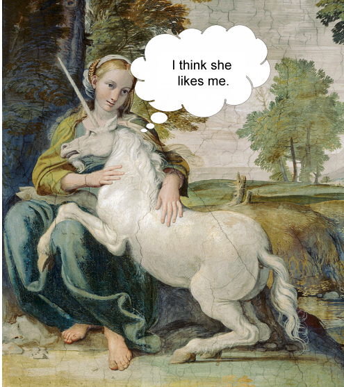

Actually you can add bubbles and text to an image in one step by using Transformation/Layout. Here is an example:
Here is how I created the image.
First, open the base image and the bubble in PWP. Create a mask for the bubble. The mask should delineate the background around the bubble. The mask FlashFill tool does this in one step. (This only has to be done once per bubble.)
Then:
1. Open the Layout Transformation.
2. Select the base image into Panel 1.
3. Select the bubble and mask into panel 2. You can size the bubble and position it as desired on top of the base image.
4. Create a third panel and type in your text. Position the text in relation to the bubble as required.
That's it. Click OK and you have an image with the bubble and text.

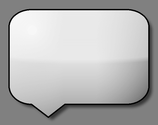

Noticed that a number of Free clipart speech bubbles here: https://openclipart.org/tags/speech%20b ... ble&page=1 had drop shadows, button shading, and color...
Here is the previously posted "TextShape03" modified with PWP's DropShadow and Button transforms:
Used with Composite-HardLight and a mask to provide a mirror-ed, semi-transparent 3D appearance:
...just exploring limitless possibilities... ...What's next? Maybe a Tint to provide a 'color cast' inside the text Shape??? ...added Texture???...
P.S... ...looks like I forgot to mirror the 'text drop shadow' in the example... ...anyone notice??? ...the devil is in the details for manufactured photo realism and graphics...!!!

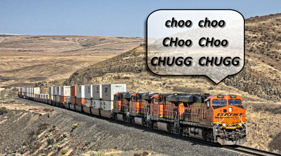

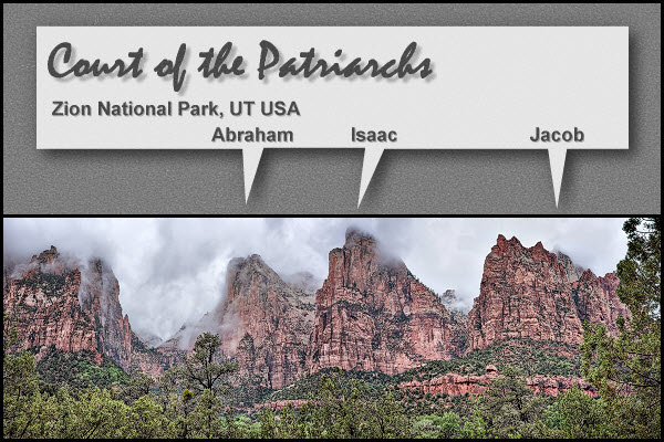

I had the need to add some text dialogs to a presentation... ...so I 'saved' the following "<name>.poly" file to the .../Picture Window/Shapes folder...
Start text copy below this line_______
Polygon 1.0
npts 13
vertex 0 0.2430 0.6314
vertex 1 0.8005 0.6314
vertex 2 0.8005 0.3481
vertex 3 0.5955 0.3481
vertex 4 0.6024 0.2249
vertex 5 0.5459 0.3481
vertex 6 0.4996 0.3481
vertex 7 0.4745 0.3481
vertex 8 0.4500 0.3481
vertex 9 0.3340 0.3481
vertex 10 0.3156 0.3481
vertex 11 0.2925 0.3481
vertex 12 0.2430 0.3481
end
# Comments:
# 1) This is a rectangle with one
# pointer with provisions for two
# additional pointers along the
# bottom rectangle edge
# 2) Copy text to a 'plain text'
# editor [Notepad] and 'Save As'
# "<name>.poly" to:
# C:/Users/<user name>/AppData/Roaming/
# Digital Light and Color/
# Picture Window/Shapes
# Created by ...den... 160306
End text copy above this line________
The above will provide the Mask Tool - Polygon feature with a mask shape as described in comment 1) when loaded... ...Utilizing it with Composite-Blend, Drop Shadow, Texture, and Text transforms, the following is possible...
Note: to find the Shapes folder, you may have to change Folder Options View to: "Show hidden files and folders" and/or <AppData> may be <ApplicationData> for your OS...
I could not get a Spline version to look right so no rounded corners with straight pointers...
