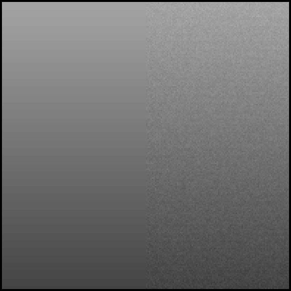

It is not natural for photo realism to have such large solid pixel areas for both the color images and the Black/White Gradient filter image... ...try adding 2 to 3 percent Gaussian noise to the Gradient filter image... ...then Composite-Blend.
Illustration: a partial vertical Gradient filter image comparison at 3:1 zoom with the approxiate change in gradient as described in the OP... ...right half is shown with an added 2.5% gaussian noise...
At normal resolutions and viewing distances the striations/noise most likely will not be noticeable...

Den, I tried a small amount (actually tried a couple different amounts) of Gaussian noise as you suggested, however, it makes little difference in the mask as the banding is still visible.
