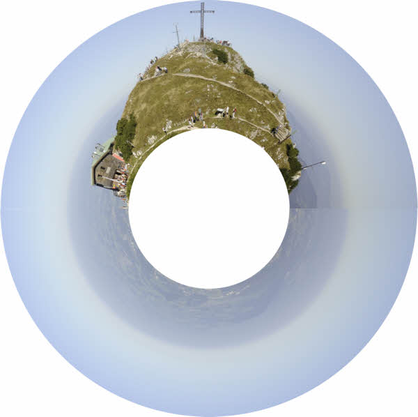

I don't have a real 360° Panorama on hand, so there is a diskrepancy at the 3 o'clock position, but does not matter for the method.
The original image is 4116 x 580 pixel (just a panoramish coutout from a bigger image).
With Crop I cut it down in 2 images 2058 x 580 pixel.
Then a Fan transformation for a 180 degree fan, Curvature setting for Fan to 88,48%
A little crop of 3 pixel at the bottom to get rid of the small white border left by fan.
Adding the additional space to composite to the upper image with crop-Add border, the same size as the upper image.
Rotating the lower halve image at 180 degree and add it in with composite.
The result:
- Fan_Planet.jpg (25.61 KiB) Viewed 9408 times
