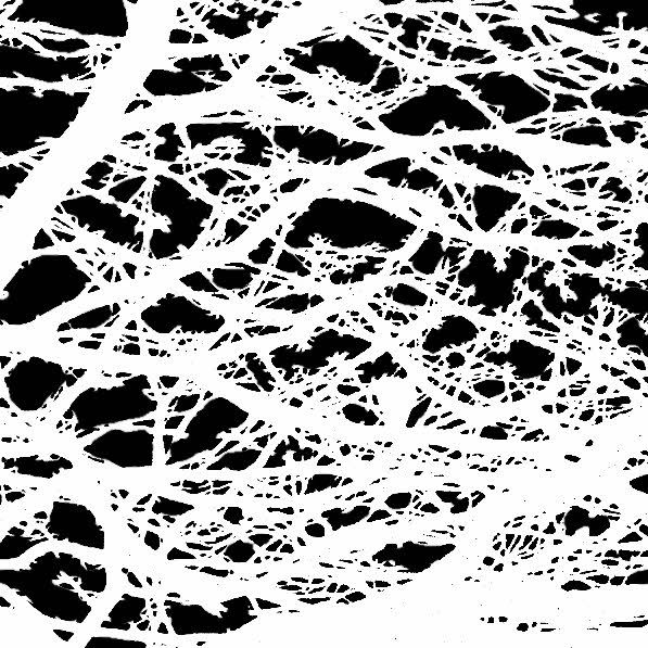

I am working on a project where I have generated a mask of a tree (started out in fog). I have removed extraneous stuff and the result is a single white tree against a black background. The tree has no leaves but a lot (a real lot) of branches. The trunk of the tree is a couple - three hundred pixels wide (at least) and the smallest branches are perhaps 5 pixels thick, or so. So far, so good, however, I have been trying to reduce the number of small branches, while retaining the larger branches and trunk to make the image "less busy". Initially, I lost some of the smallest branches by upping the contrast (by moving the grey levels and colour slider to extreme ends of the scale, past the full range, to the point that it is only pure black and pure white now). However, this did not lose many of the smaller branches that I am looking to do. I have tried applying a negative feather, then using the grey levels and colour slider with only the black side pushed beyond the full range. This tended to reduce some of the smaller branches, but had the negative side effect of adding "prickly" like nubs along the branches and trunk, and making the image look less realistic. This problem increases the more times this process is applied.
Can anyone suggest a method to accomplish what I am trying to do, while retaining the semblance of a tree?? I could do a whole lot of pen tool and write over the smallest branches with black, however, there are a whole lot of these branches and it would take me weeks to do (at over 1:1 resolution). Hopefully someone can suggest a quicker, easier way.

At the suggestion of another member, I am attaching two images to show others the mask I am working on to, perhaps, give everyone a better idea of my initial post. One is the full image (lightly cropped to eliminate as much black as possible), while the other is a 600 pixel square full res image which gives a clear view of the branches. As initially stated, I am trying to find an easy method to eliminate the thinnest branches while retaining the larger, so the mask is not so "messy". As I use tree masks like this quite a lot in my images, I am looking for a quick method that can be used repeatedly.
Hope this image attachment thing works.....

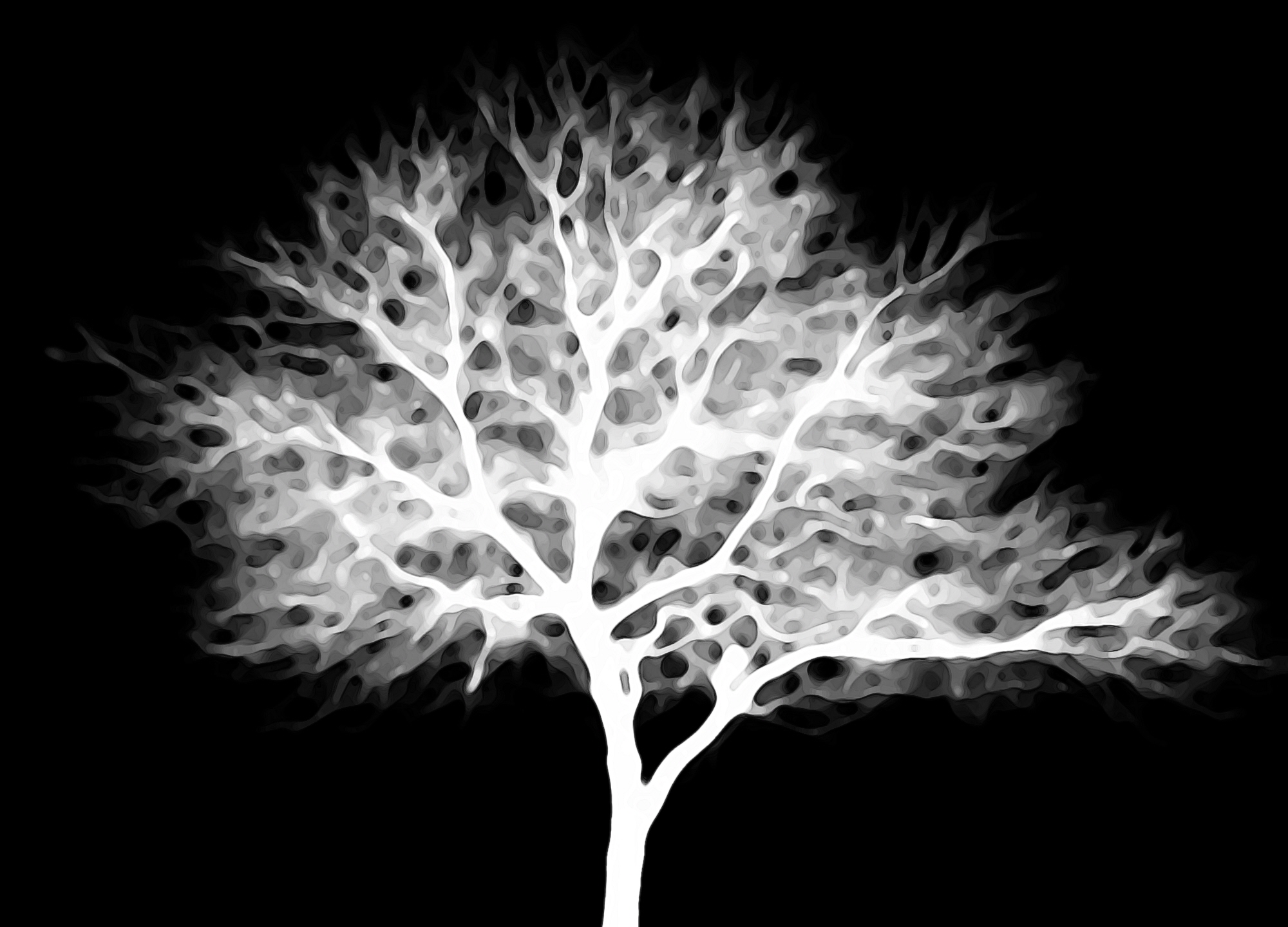

If what you want is a less literal rendering of tree, I would suggest you try the Watercolor Transformation (It's under Special Effects). Watercolor has a number of settings that you can play with to get the result you want.
You will probably want to apply it to the image itself, not the mask. However just to show what it does, here is a fairly aggressive application of watercolor to the mask.
If you decide to try it, please post your before and after results.

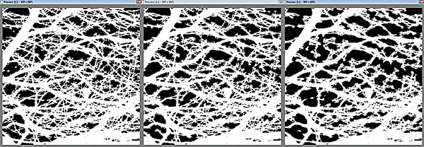

Quite straightforward metod might be to use the mask flood fill tool with the right Threshold which allows only branches up to the minimum acceptable thickness to be included into mask.
The attached example (intentionaly aggresive settings):
First use the mask tool Flood Fill, here with the Threshold = 100, click on the trunk, Blur radius = 1 Apply, then OK or Apply Mask
This is the most important step. The mask blur of just a radius = 1 is used just to remove the excesive crispness of the remaining branches.
After that you might want to use the Unsharp Mask, here the Radius = 2 - right part of the attached example
or perhaps already suggested High Contrast, here the Threshold about 40 - left part of the example
You can even tune the branches a little bit more down by filtering the image with itself using Filter transformation after converting it to 24-bit color.
