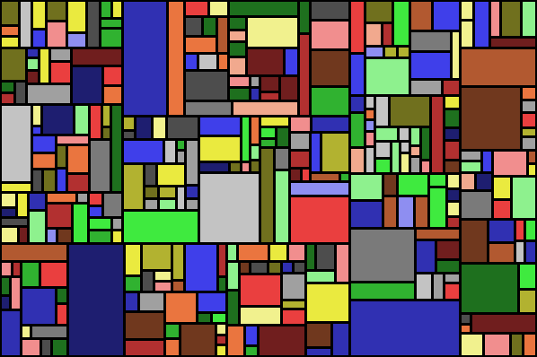

There is a "graphics random size color rectangles" 600x400 image [click on the Plate 7.3 thumbnail] here: http://www.cs.arizona.edu/icon/gb/plates/plates.htm
which I have modified to have black borders/spaces:
Interestingly, there is a link to code that appears width and height could be set to 6000 and 4000, which may avoid the appearance of repeating patterns when using PWP's Tile transform with the 600x400 image but perhaps the size of the rectangles would be up-scaled as well. I did not investigate.
Note: I reduced image's borders so that when "tiled" they would be approx 4 pixels... ...and when "tiled" 10 horizontal repeats and 10 vertical repeats with no mirrors, the actual size will be 5980x3980.

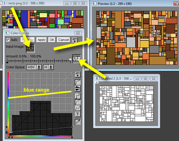

...Perhaps, the following would be helpful to speed up the coloring process while at the same time limiting HSV-Hue to a narrow range, orange for example, of the previously illustrated 400x600 rectangle image:
(1) create a mask to limit color changes only to rectangle image areas protecting the border/background image areas so that they remain black...
(2) use a HSV-H Color Curves transform as illustrated... ...possibilities are almost un-limited when changes to the HSV-V and HSV-S curves are made as well... ...in the illustration, these channels remained unchanged:
For a 'blue' HSV-Hue range, relocate vertically the nearly horizontal straight-line curve between 60 and 70 of the vertical axis...
