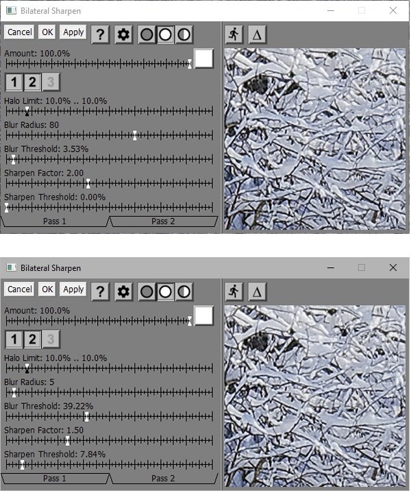

Do you use Bilateral on the default setting?
T
Re: RAW woes
Posted: December 19th, 2019, 9:25 am
I have my bilateral sharpen defaults set as follows:
bilateral sharpen settings.jpg (125.77 KiB) Viewed 10650 times
The contents of the Default.bilateral sharpen file is:
bilateral_sharpen 0 amount 1 -1 0 0 ″Amount: ″ ″Mask″ npasses 2 display 1 sync_scroll 1 pass1 1 80 9 0 2 0.1 0.1 pass2 1 5 100 20 1.5 0.1 0.1
This does some large scale local contrast enhancement in the first (radius 80) pass which is good a bringing out cloud and other coarse detail. The second pass (radius 5) is a straight sharpening pass to bring out fine detail. To get two passes you need to use the Settings menu and select 2-Pass Sharpening.
This combination tends to over-sharpen a little so, depending on the image, I may dial back or eliminate one or both passes.

Hmm. Has this changed? I don't have the Pass 1 and Pass 2 tabs and button 2 and 3 are greyed out and can't be depressed. I just downloaded the latest update.
Re: RAW woes
Posted: December 20th, 2019, 3:35 am
by Winfried
Did you enable 2 or 3 Pass Sharpening with the setting menue (litte stearing wheel) ?
Re: RAW woes
Posted: December 20th, 2019, 4:04 am
by croos
Duh. My only excuse is I've just started to look at v. 8. Everything is so different from what we are used to.
Thanks, Winfried. :-)
