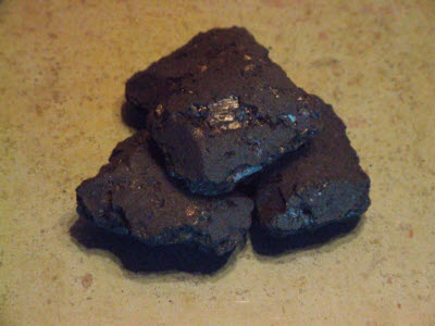

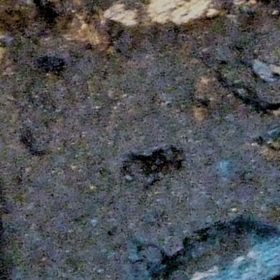

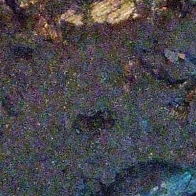

Maciej, unfortunately i'm in lack of a black cat so you I just could take a pile of (char)coal as a example.
Setup is: Camera set to ISO1600 to get a good amount of noise to easily see a difference in S/N ratio.
Camera as a Fuji S9600 bridge, JPEG in maximum quality, quick and dirty tabletop setop, the coals placed on a piece of sheet metal (due to the mostly dirty nature of the coal in the quick and dirty setup I did not want to spoil a piece of textile or paper background, so the less optimal solution with the sheet metal.).
First a over all, resized picture:
A 1:1 crop of a "correct" exposed image ( F 4.0, 1/15 sec.)
A 1:1 crop of a "ETTR" exposed image, brightness shifted back to "correct" (F 4.0, 1/6 sec.)
No other editing is done, just the shifting of brightness at the ETTR image and cropping.
I think it can be clearly seen that the noise is considerably lower.
