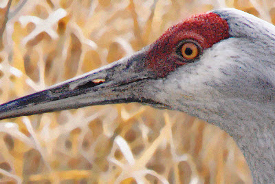

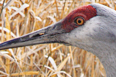

Certainly no where close to the real thing, but you might try experimenting with multiple Median 5x5 Blur passes plus added RGB Gaussian Noise on the image's background after extracting the main subject with a mask... ...at least there is not the fogging nor main subject edge halo that a Gaussian Blur produces...
Original image, 1:1 image area... ...slight existing len's bokeh:
10 passes of Median 5x5 Blur plus 10% RGB Gaussian Noise on the background with the main subject masked:
...perhaps an added 'tone/contrast' curve could be used to further achieve a background preference... ...and Dieter's suggestion regarding a gradient for an increasing blur with distance is an important consideration.
