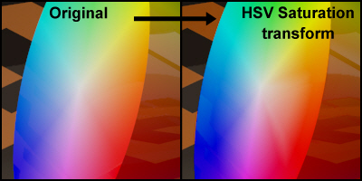

The reference SkinColors image previously posted and its use with the Mask Tool - Color Range feature and the Saturation transform in HSV mode is described here: "Vibrance vs. Saturation and PWP's Saturation transform": http://www.dl-c.com/board/viewtopic.php?f=4&t=594
Used in the manner described, it can provide an uniform saturation change in the HSV-H,S plane [color hexagon or color wheel] while at the same time protecting SkinColors and High saturations... ...for example:

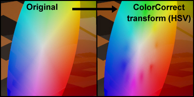

...However... for a quick straight forward approach, the Color Correct transform with the purposed preset can also provide vibrance [protect SkinColors and High saturations] inspite of its lack of uniformity. Sometimes its lack is a preference. For example, if the Preview image's sky is too Blue [HSV-H = 66.7%], its arrow can be shortened as well as the adjoining Aqua [HSV-H = 58.3%] and Purple [HSV-H = 75%] hue arrows... ...and more SkinColor 'blocking' control points can be readily added... ...all are changes that can 'customize' the HSV-H,S color hexagon to a preference for a specific image... ...for comparison with the Saturation transform illustration, here is an illustration of the suggested vibrance ColorCorrect preset:
Again... ...for most photo realistic images, the lack of an uniformly applied saturation change is not readily apparant and provisions for 'artistic' control for specific colors are available.
