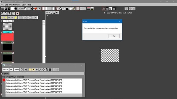

And here is an interesting screen shot:
When the Open File list was cleared, I clicked OK in the File Open anyway, getting the error in the Change Profile transformation. So I repopulated the list, but the error remains.
- PWP Error.jpg (28.71 KiB) Viewed 2432 times

The Batch Image window is a modal dialog box that is displayed only when PWP needs you to choose what to do. It disappears when you click one of the buttons and then re-appears as necessary. It was supposed to be impossible to click any controls outside the window, but I did not properly disable the other windows -- which I have fixed for the next release. To avoid problems, when you see the Batch Image dialog box, just click one of its buttons and leave the other windows alone.
