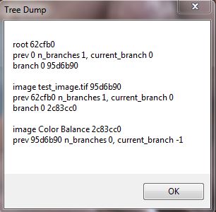

I have replaced the test version on the download page with a new one. It removes the previous debugging code, fixed some minor problems which might possibly be causing the symptoms you report (but I doubt it), and adds a new feature:
After you load your image and run the transformation, but before you click the x to close the input image, type Ctrl-D. This will pop up a small window with some numbers in it that represent the structure of the image tree. If you could take a screen shot of that and upload it or email it to me at jsachs@dl-c.com, then I can tell if the integrity of the image tree has been compromised or if the problem is in analyzing the tree to count the downstream images.

- PWP 8 Tree Dump.JPG (25.91 KiB) Viewed 7677 times
Re: An open dialog with no input image, reposted.
Thanks, your help is invaluable.
The tree looks OK, so now I need to examine the code that counts downstream images.

I think I found the problem. I'm willing to bet that in the image browser you have not turned on the colored button next to the + and - that highlights dependencies, and that if you do, all your problems will disappear.
I still need to fix this, but try the workaround and tell me what happens.
