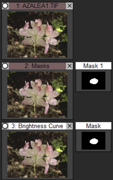

Re: Mask and operation time issue
As with PWP 7, the mask must be exactly the same size as the image, so if the two images have different sizes, the mask will not show up in the list. Also, the Masks transformation must be upstream from the image you are trying to apply it to (i.e. it must not depend of the image you are trying to apply it to) (see attached example screen shot). If the Masks transformation comes after the Brightness Curve the mask will not show up on the list as this would be a circular reference.
