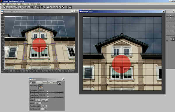

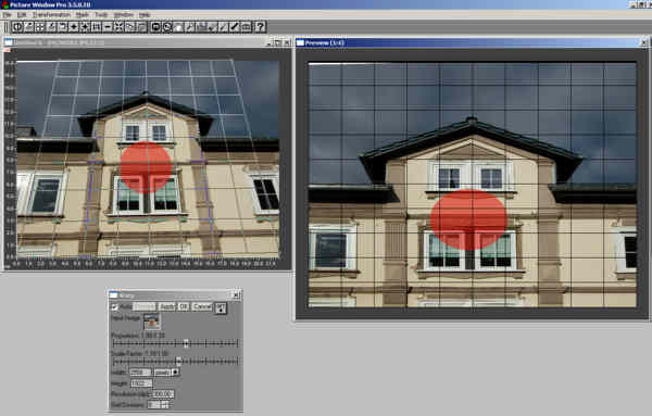

Just to let you know, Jonathan is making available to me his back up files for the old Message Board threads/posts and we are slowly developing [but progressing] something to preserve some of their hidden treasures... ...for example, Winfried's January 2, 2006 post regarding the Warp Transform proportions slider:
Warp Transformation
If you use the warp transformation for instance to correct a picture of an building, I found this litte trick helpfull to find the right setting for the proportion slider.
I use the paint tool and create a big round spot on the original picture. Then I change the proportion slider until the spot is round again.
After I found my setting I use "cntl z" to undo the spot.
Before
After
I have used this tip many times, recently as last week... ...How many of you have forgotten the Cntl Z part before a transform Apply or OK ??? ;-)

I must have missed that one -- that means there must be a way to set the proportions slider automatically using a little math. I had always assumed you needed to know the field of view of the image (lens FL and sensor dimensions) to correct the proportions.
Thanks for dredging it up.

Actually while this sounds like a great idea, it does not work in general as I found out when I tried to implement it. For example, if the circle gets warped into a rotated ellipse - which is common - there is no way to un-rotate it by simply adjusting the proportions. There may be some other method that works all the time without knowing the field of view, but I am not aware of it.
Re: DL-C.COM Maintenance
Posted: June 13th, 2017, 2:16 pm
... True... I will just adjust proportions so that the ellipse if it occurs is not overly elongated or tall. It will work as a guide especially where there are no straight lines in the image... ...otherwise I try to adjust so that image elements look near natural unless going for an artistic nuance.
