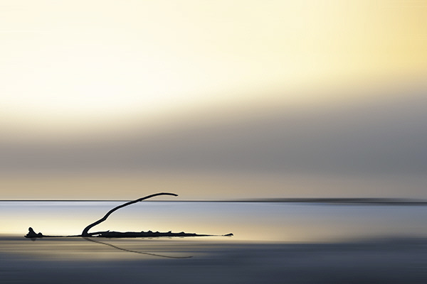

I am attaching three images. The input image will be the water scene/sunset with a dark log (bottom left), which I composited in from another photograph. I wish to lay down a shadow on the near side of this log. To do that, I flipped the original mask (second attached image) of the log (which I used to composite the log) and found a generic greyish image (third attached image) that I will be using as the overlay image and compositing into the water scene/log image (with a soft light or other blend mode).
Initially, I thought I could use the warp transform but ultimately decided to use the Composite Transform, with multi-point mode (which you also suggested early on). I need multi-point because the log shape in the mask and the log in the input image, do not marry up very well so I need to bend the shadow in multiple locations to meet up with the side of the log.
When I did that, I could only get the result shown in the first image I attached to a prior post.
Because there was some confusion, I thought I would do up a quick example with the hand-drawn black line on a white background and use that line as a simple mask. As I described in an earlier post, things went fine until I reached point "c" then the image went askew, so I posted that result in the next post to show you what I meant. It seemed that whenever I tried to place a point beyond the letter "c" (in both examples), the masked in object went crazy. And at your suggestion, I used the Gaussian Method. That's why I asked you to try and duplicate the line drawn example, to see if there was a bug somewhere or I was just doing something wrong and the fault was mine.

At first I could not see what you were doing, but then I experimented with the samples you posted and did see the problem so I edited my previous posting with a suggestion.
I understand the idea of putting an upside down shadow under the log, but I don't understand what you want the end result to look like. If you just wanted to line up the upside down log with the right side up log and composite the background you can use composite with 2-point alignment, but you seem to be trying to achieve some other effect.
If you could create an acceptable mask for the log shadow, you could use the Brightness transformation to darken the original image just in that area to simulate a shadow.
I took your images and registered the mask to the log in the input image using 3-point alignment so I could shear the mask to make it look like the sun was coming from an angle. Then I used the sheared mask with the Brightness transformation to darken the masked area.
Log with shadow
Log with shadow
Log with shadow.jpg (33.78 KiB) Viewed 6210 times
