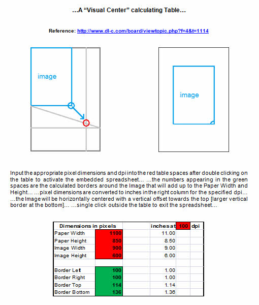

I put my own 'spin' on DieterM's spread sheet and used an Office Word document (*.doc) with an 'embedded' spreadsheet as an User Interface... ...if of interest:
The spread sheet can be edited to your own purposes using Excel commands....

Den,
the calculation will definitely make the things faster end easier. Thanks.

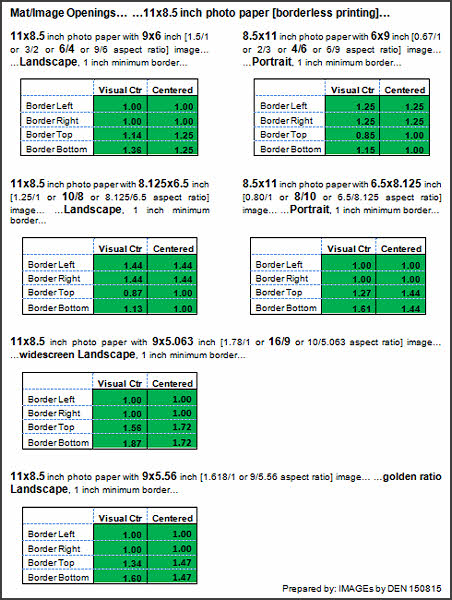

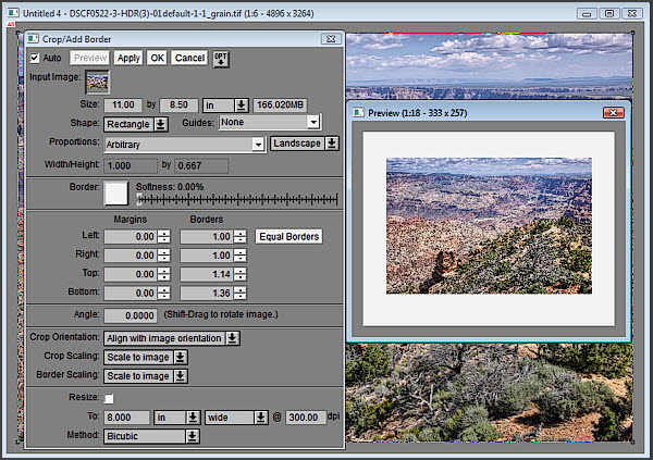

Apologies for continuing this thread but I got tired of bouncing in/out of the previously suggested calculation work sheets... ...and summarized them for 11x8.5 inch borderless photo paper printing of various aspect ratio images with an approximate 1 inch minimum border to maximize the image size... ...apologies to DieterM as well as I did not include metric/European standards...
Part 1 of 2...
The following is a Word document with tables which when unZipped appears:
Illustrated is the Crop/Add Borders transform settings for a 4896x3264 pixel Landscape image with a 6x4 inch aspect ratio when printed 9 inches wide to leave 1 inch borders Left and Right results in a resolution of (4896 pixels/9 inches) = 544 dpi... ...with Visual Center plain borders:
...den... (continued in Part 2)

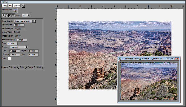

Part 2 of 2... ...(continuation of previous post)...
Illustrated is the Mat & Frame transform Image tab settings for the previous 4896x3264 pixel Landscape image with a 6x4 inch aspect ratio when printed 9 inches wide to leave 1 inch borders Left and Right results in a resolution of (4896 pixels/9 inches) = 544 dpi... Note: Inner and Outer tab Border widths = 0.00 inches as well as Frame and Wall tab widths = 0.00 inches... ...with Visual Center plain borders:
I hope that the preceding is useful... ...with a little bit of add/subtract/multiply/divide, the Crop/Add Borders and Mat & Frame transforms when using consist resolution [dpi] can be very precise for borderless photo paper printing.
