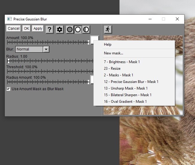

Noticed that PGB Amount mask pull-down menu includes wrong sized masks.
In this example, only "23 - Resize" should be in the selection list (at least that's the way I remember it working previously).
Posts: 4883
Re: Update Available - Version 8.0.75
OK, I see the problem -- I introduced it recently when trying to fix a problem in Composite with masks not showing up in the menu. I put the code back the way it was and am working on a different fix for the Composite bug.

Posts: 4883
OK, I think I have the Amount menu working again with the Composite bug fixed as well. Will do some more testing tomorrow and upload a new version.
