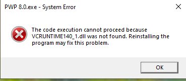

"Visual C++ 2015 Redistributable DLLs"
link on the download page fix this?

Try this one:
https://aka.ms/vs/16/release/VC_redist.x64.exe
I know this looks like a suspicious URL, but it comes directly from the Microsoft web site:
https://visualstudio.microsoft.com/downloads/

I found a copy of this *.dll already in another program folder; made a copy; and pasted it to PWP8's program folder. PWP8 then started/opened from its desktop program link.

Using the link that Jonathan provided also worked.
