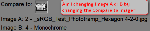

p.s. A labeling suggestion for Compare to: perhaps label it as Compare to B:? - now I remember it is always B, but I had a difficulty to figure out which image I'm changing when clicking Compare to:

Forgot to explain myself as to the Compare labeling suggestion: the A and B are listed below, but I didn't know for a while that Change to button changes image B, not A.
Maybe 'Compare A to:' label for the button or something similar to signify that it is Image B that is being changed could make it clearer? It's cosmetic anyway as it's always B, but you have to know it.
- 2020-01-05_162438.png (13.89 KiB) Viewed 2486 times

Right, I changed Compare To to Image B.
