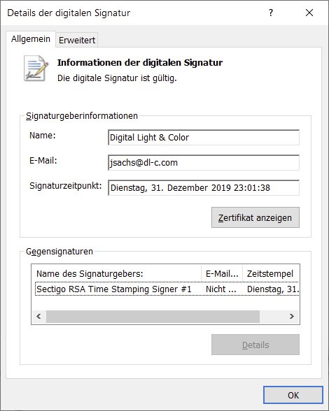

Posts: 247
Re: Digital Certificate
No problems with my System. I use Windows Defender too. No other virus-checker.
I use just "local" accounts. No accounts in the "Windows Cloud".
One account with admin rights and one without, which I normally use for everydays work.
I download the setup-file (*.msi) to NAS-storage, where I keep most of the software I run on my system.
From this NAS-storage I install with my non-admin account and I am naturally asked for the admin password during the installation process.
No warnings regarding a missing or wrong cetificate.
The file explorer shows the certificate in the *.msi-file and the PWP 8.0.exe
Everything is fine as far I can judge it.
