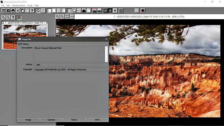

My quest is fairly simple (I guess nothing is simple in this area...): I'd like to strip processed images from most metadata other than ICC, and stamp them with Author and Copyright (and Description sometimes).
This is pretty much what PWP8 EXIF Notes displays. I also would like those notes to be fairly universally readable in any other software.
Stripping metadata and attaching sRGB ICC profile is easy. For editing Author/Copyright I used ExifToolGUI, which seems to still work, I just have to re-learn it (perhaps there is something better or simpler now?). Also, PWP7 can enter/edit those fields in batch, I believe...
My question is this: which fields and by what means should I write my Author/Copyright/Description info to?
There are EXIF Artist and Copyright and Description (as well as UserComment) fields (I suspect that this is what PWP8 is reading?)

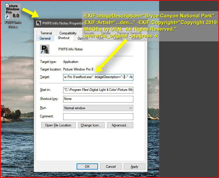

FYI... I like the challenge to learn about PWP8 and how relatively minor knowledge of programming can make Win10 and PWP8 scripting work... so regarding PWP8's Image Info Notes tab additions/edits/deletions...
1) Create a desktop program link to exiftool.exe located in PWP8's program folder. The neat thing here is that it already is a Windows executable and JS has generously not blocked access nor limited its features.
2) In the desktop shortcut link Properties->Target box, add the following ExifTool Options in a string after "C:\....\Picture Window Pro 8\exiftool.exe" leaving a space in front of the first hyphen and each subsequent hyphen:
-EXIF:ImageDescription="Bryce Canyon National Park"
-EXIF:Artist="...den..."
-EXIF:Copyright="Copyright 2019 IMAGEs by DEN. All Rights Reserved."
-overwrite_original
-progress
-k
3) Select Apply after the Options have been added or any changes to them have been made. The suggested Option list will add/change/delete: ImageDescription; Artist; and Copyright with whatever is between the " " marks; without creating back-up *.*_original files; create a desktop progress report and a program pause so that the report can be read and manually closed.
4) Using Windows File Explorer, select one or more image file names; drag and drop the selection on the ExifTool desktop shortcut. A progress/status report will be generated on the desktop. The image file or files will be updated with no changes to pixel data and remain in their selection folder or folders. .
Have fun self-programming a variation of Command Line and utilizing Windows OS features to perhaps better your PWP8 experience.
There are numerous GUI's for exiftool but sometimes its just interesting so see/understand what possibilities are 'under the hood'.
P.S. Noticed a discrepancy in the Options list vs. those in the illustration. A -EXIF: prefix is not always necessary to idendify tag groups with a tag name but it is the best practice.

I'm still experimenting, but to add to Den's recipe: if such shortcut is moved/copied to
C:\Users\<yourusername>\AppData\Roaming\Microsoft\Windows\SendTo
right-click/Send To in windows explorer will allow applying the script to selected files, which may be more convenient than dragging files onto the shortcut.
