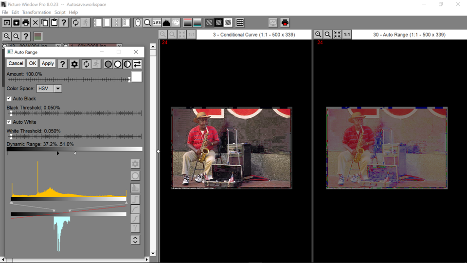

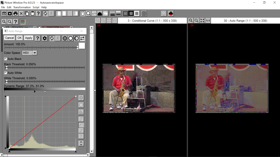

Cheers! But should the Autorange display the curve that it's applying to the input histogram? Please take a look at the screenshot - I'm having a hard time to move this curve.
- Capture.PNG (299.5 KiB) Viewed 2488 times

This is interesting: if I change the Default Curve Options in Preferences to dual histogram and restart the Autorange, it shows input and output histograms properly (I think) but, just like the curve previously, is unreactive to changes to the Dynamic Range slider.
- Capture1.PNG (292.42 KiB) Viewed 2486 times

The Autorange displays Curves version of the histogram now, regardless of Settings. But while I understand that it shows the input histogram only and the controls are disabled, the actual mapping Curve seems to still behave strangely:
- Curve stays diagonal regardless of Dynamic Range slider adjustments
- The Curve does react to an initial adjustment of Thresholds, but also not quite right to my eye, and gets stuck from there on
- Resetting the transformation returns the curve to diagonal
I can attach screenshots if this can't be replicated.

OK, I fixed the Autorange curve for the next release so it responds to changes in the dynamic range slider, although this does not add any useful information.
Changing thresholds is, as far as I can tell, working OK. This may or may not have much effect, depending on the image.
The way autorange works is to scan the input image histogram from each end, advancing until the sum of the histogram bars exceeds the threshold times the sum of all the histogram bars. This trims off a small percentage of the highlights and shadows to find the white and black points. If you just search for the lightest and darkest pixels, a single stuck pixel, dust speck or tiny specular reflection can set the white or black point in an undesired way.
The main purpose of the curve is to show you what parts of the histogram are being cut off.
