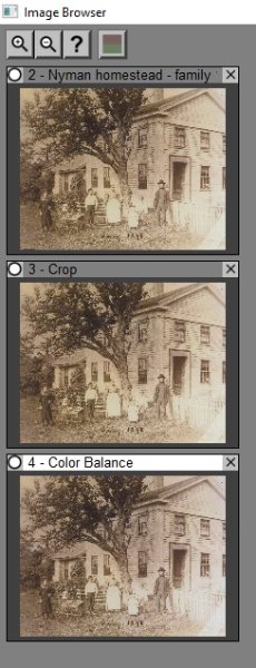

Now using 16 Jun 2019 beta, but I'm still not seeing the S save icon on the thumbnails in the image browser.
No save icon.jpg (39.54 KiB) Viewed 5123 times
The bottom image in the browser shown above has been saved
Image has been saved.jpg (49.43 KiB) Viewed 5123 times
The referenced image has been saved
Am I missing something?
Thanks, Bob

Re: Bug fix release 11-Jun-2019
I tried to reproduce your workspace and I do see the S icon here.
Are you sure you are not using an old version?

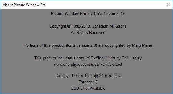

16 Jun 2019 version.jpg (25.52 KiB) Viewed 5119 times
And I unstalled the old version first.
BobP
Windows 10 Home, 64-bit, 16 GB RAM
I found the problem -- the S icon bitmap was not included in the install script so it was not getting displayed. Fixed for next release.
