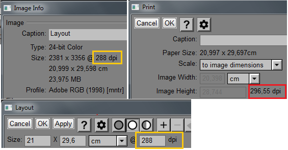

When I want to print the layout with an image, I see a different dpi information in the Print dialog: incorrect 296,5 dpi, than there is in the Layout dialog and the layout Image info, both show correct 288 dpi. See the attachment.
There is no such difference in the Print dialog when I try to print the image itself outside the Layout transformation.
If I am not mistaken, 296,5 dpi is what is sent to the printer. I would prefer it the other way round: 288 dpi sent to the printer.
Incorrect dpi information in the Print dialog

From the screen shots, it looks like the physical dimensions of the image exceed the page size so the image was scaled to fit the page which resulted in the slightly increased dpi.

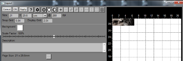

The image is just a test print patch abput 6,5 x 2 cm.
- Layout dpi.PNG (52.22 KiB) Viewed 6266 times
Re: Incorrect dpi information in the Print dialog
I used Add Border and Composite to create the same test print patch. It is composed of 4 individual crops. The Print dialog shows the correct 288 dpi, however when I use the cropping rectangle horizontal lines to make the image smaller, the dpi in the Print dialog changes. It varies between 281 to 288. I would not expect any changes in dpi when cropping an image for print.

The Print command is working correctly as far as I can tell. The image size as shown in Image Info was too big for the available space between the margins and the image was reduced in size. If the image dimensions are small enough to print unscaled, the correct dpi is displayed in the Print dialog box and it does not change when you crop. If the image is too big to fit in the available space, it is scaled and the dpi changes. If you add margins to the image, the total size must fit between the print margins -- the image margins cannot overlap the print margins.
OK, the problem was that the Layout dimensions were larger than the printing area: the paper dimensions minus the margins. I mistakenly entered the printing paper dimensions as the layout dimensions not thinking about margins.
