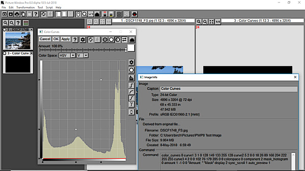

"Load color curves" for the Color Curves transform settings is no longer working properly...
The following "PWP8 HSV Test color curves.cc" file was formed and Saved but the V channel did not save properly [it had the control points illustrated]:

was Color Curves\Settings\Load color curves... yields:
Screenshot (1)-1.jpg (145.45 KiB) Viewed 2253 times
The H and S channels load properly and the V channel has correct control points but the curve is a horizontal line at vertical = 0 [black].
Image Command info:
color_curves 0 curve1 3 1 0 128 149 133 255 128 curve2 5 2 0 0 18 26 89 166 204 222 255 255 curve3 4 2 0 0 102 76 179 205 0 0 colorspace 0 component 2 mask_histogram 0 amount 1 -1 0 0 ″Amount: ″ ″Mask″ display 2 sync_scroll 1 auto_preview 1

PWP8 created the file... ...added edit: There should be 4 points for npts3 but apparently only the first two got Saved. Look closely at the V channel grid, you will see white control points for a spline S-contrast curve except for the one at 255,255.
