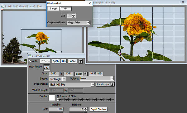

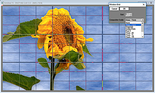

If of interest for those with a Windows OS, the following suggested plain text when added as the first 'begin_object' to the "PWCompositionGuides.txt" file located in the "C:/Users/<your user name>/AppData/Roaming/Digital Light and Color/Picture Window/" folder will add a 'Nines - Thirds' composition guide selection at the top of the drop menu of PWP's "Window/Grid..." dialog...

Illustrations:
Screenshot (1)-1.jpg (173.98 KiB) Viewed 10881 times
Screenshot (4).jpg (255 KiB) Viewed 10881 times
If anyone needs further 'how to', ask...
