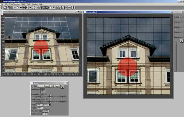

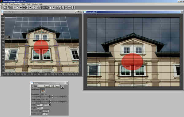

Just to let you know, Jonathan is making available to me his back up files for the old Message Board threads/posts and we are slowly developing [but progressing] something to preserve some of their hidden treasures... ...for example, Winfried's January 2, 2006 post regarding the Warp Transform proportions slider:
Warp Transformation
If you use the warp transformation for instance to correct a picture of an building, I found this litte trick helpfull to find the right setting for the proportion slider.
I use the paint tool and create a big round spot on the original picture. Then I change the proportion slider until the spot is round again.
After I found my setting I use "cntl z" to undo the spot.
Before
After
I have used this tip many times, recently as last week... ...How many of you have forgotten the Cntl Z part before a transform Apply or OK ??? ;-)

Actually while this sounds like a great idea, it does not work in general as I found out when I tried to implement it. For example, if the circle gets warped into a rotated ellipse - which is common - there is no way to un-rotate it by simply adjusting the proportions. There may be some other method that works all the time without knowing the field of view, but I am not aware of it.
Re: DL-C.COM Maintenance
... True... I will just adjust proportions so that the ellipse if it occurs is not overly elongated or tall. It will work as a guide especially where there are no straight lines in the image... ...otherwise I try to adjust so that image elements look near natural unless going for an artistic nuance.
