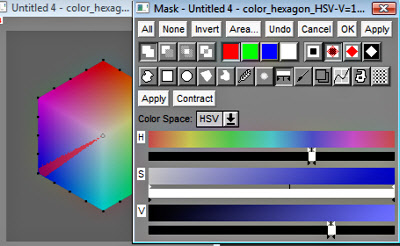

What do you mean
by being able to select a single hue/tone
For example, I changed the normal default Value from 100 to 75% for a Color Dialog Hexagon image and set the Color Range for the Mask Tool to mask a narrow Blue Hue [67] range, to include all Saturations at a narrow Value of 75...
If the 75% toned Color Hexagon were a photo, the mask would map all pixels within a narrow range centered at Hue=67 [Blue]; Saturations=0 to 100; and a narrow range centered at Value=75.

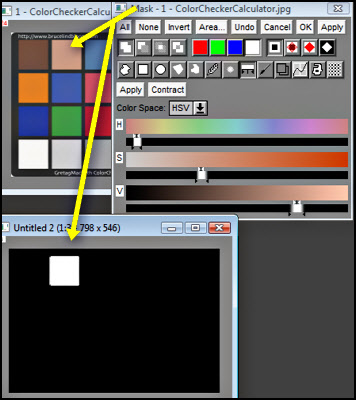

Mask Tool - Color Range can be used to pick a 'narrow' range of colors/tones centered about a preference 'solid' color/tone... ...for example, the following illustration has color range settings to map the "light skin" square of the Macbeth ColorChecker chart...
At the risk of adding more confusion until understanding is achieved, the following may be of interest...
Mask Tool -- Color Range considerations/settings for 'nearly solid' color/tone masking of non-adjoining image areas scattered throughout an image...
Color Space considerations...
(1) To mask a 'nearly solid' color/tone; not near Red in Hue [0 or 100%]; 25-75% Saturation; and 25-75% in Value... ... use the HSV color space.
(2) To mask a 'nearly solid' color/tone; not near Red in Hue [0 or 100%]; 0-50% Saturation; and between 0-25% or 75-100% in Lightness... ... use the HSL color space.
(3) To mask a 'nearly solid' color/tone; near Red in Hue [0 or 100%]; any Saturation; and any Value or Lightness... ... use the RGB color space.
Using the color space selected from above: Sample [left mouse click] an image color/tone [a vertical black line appears below each of the channel color bars]; do not Contract; manually move for each of the channel color bars, the left side white slider pointer to the right until its point touches the vertical black line; manually move for each of the channel color bars, the right side white slider pointer to the left until its point touches the vertical black line; and 'lower-left' Apply Add... ...if necessary: Add or None or Undo; re-adjust the white slider pointers and their compainion black slider pointers [applies blending gradients to the color range selection of the white slider pointers]; and 'lower-left' Apply Add... ...repeat as preferred.
Add'l Notes...
(1) Once an image color/tone has been Sampled, the Mask Tool -- Color Range color space can be changed... ...the vertical black line below the channel color bars will shift appropriately for the newly selected color space.
(2) After making the white pointer slider adjustments, make sure that the left and right sliders 'point' towards each other as they can be easily crossed where they are back to back.
(3) In PWP, Hue has discontinuity for Red at any tone [Value or Lightness] and Saturation... ...as a 'solid' Red hue can have a value of either 0% [0] or 100% [255]. Hence, a 'narrow' color/tone range centered about a Red hue may be best masked using the RGB color space when using Mask Tool - Color Range.
Hope the above is of help... ...the Mask Tool - Color Range feature can be very powerful... ...the key is masking a 'narrow' range centered about a preference 'solid' color/tone in one or more of its selected color space channels... ...then too if you are achieving your preferences via other masking methods that is the important thing!!!
