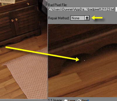

'dcraw' Bad Pixel files & PWP's Raw Dialog
Part 1: creating a Bad Pixel file...
(1) Using 'dcraw', create two raw conversions of a camera's raw file. One for basic conversion that is auto-bright sRGB gamma 2.2 colors using options: -v -w -H 2 -t 0 -o 1 -j -6 -T... ...and one to show the sensor grid in BW using options: -v -d -j -t 0 -6 -T. Rename the first tiff file before running 'dcraw' with the second set of options as it will be over-written if not done so.

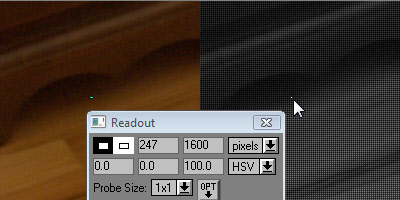

(2) Open both tiffs in PWP and Window/Arrange/Tile Vertical them so as to change Zoom Factors and navigate the images side by side.
(3) Open the Readout Tool with Probe Size 1x1 and OPT - Origin at top left.
(4) Systematically, go through the images initially looking for bright pixels in both images and record the Readout Tool's pixel values. The left value is a column and the right value is a row starting from the image's top left corner. Next, go through the images looking for 'out of place color' and broken grid crossings. Record these pixel readouts.
(5) Using a text editor such as NotePad, create a "BadPixel.txt" file. My file looks like this where the first number is a column, second number is a row, and the third number is a 0 because I am too lazy to figure out the dates. The # followed by text are comments...

Part 2: Using "BadPixel.txt" in PWP's Raw Dialog, S&N tab...
(1) Place a copy of "BadPixel.txt" in C:\Users\<user name>\AppData\Roaming\Digital Light and Color\Picture Window\Badpixels... [May have to change folder preferences to show hidden folders -- a Vista OS path shown].
(2) Using the Bad Pixel File browser, select the "BadPixel.txt" file. Change the Repair Method from None to Median or Average... the bad pixels disappear...
