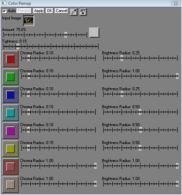

The key to understanding the Remap transform is that it is essentially the ColorCorrect transform with a different User Interface and improved gradient [feathering] controls for preference color/tone changes:
...(a) both function in the HSV color space model.
...(b) Remap uses ColorPairs instead of ControlPoints with arrows.
...(c) Remap has a Chroma radius control for each individual ColorPair whereas ColorCorrect has a universal 0->1.0 radius slider for all ControlPoints.
...(d) Remap has a readily available Brightness (HSV-V) control for each individual ColorPair whereas ColorCorrect's ControlPoint brightness [HSV-V] requires a specific control point to be 'active'.
...(e) Remap's Tightness is essentially the same as the ColorCorrect 0->1.0 radius slider providing global application of the individual ColorPair Chroma/Brightness settings. Note: Tightness is maximum at a value of 1.00 and minium at 0.00... ...an opposite effect to the ColorCorrect Radius setting.
...(f) Remap [PWP6 v6.0.9] is currently limited to eight ColorPairs whereas ColorCorrect essentially has no such limitation.
Because of improved ColorPair gradient controls that Remap offers, concerns that saturation changes are not uniform while still true should not be as great as with the ColorCorrect transform.

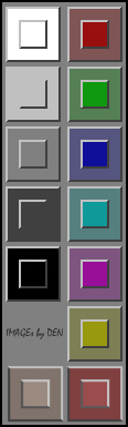

The following reference image is available for you to download and use to set RGBCMY ColorPairs for general High Impact saturation image changes... the pairs change HSV-V from 50 to 60%; HSV-S from 33 to 90% with no change in HSV-H. The 0, 25, 50, 75, and 100% gray tone [HSV-V] pairs can be used when neutralizing an image's color casts or blocking Brightness [HSV-V] changes. The SkinColor pairs can be used when saturation changes are to include Vibrance...

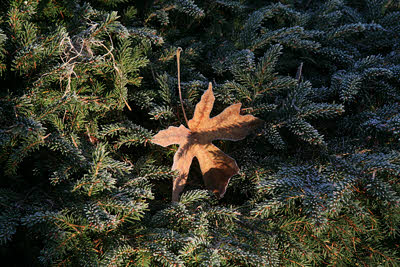

Example: Original image...

Original image saturation Remap-ped with no vibrance...

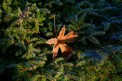

Original image saturation Remap-ped with vibrance...
IMG_8223 Remap-ped applied saturation-vibrance transform settings...
