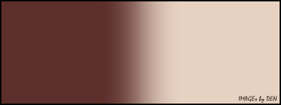

The following is a possible approach to generically mask an image's SkinColors [Hues and Saturations of the HSV-H,S color plane (sometimes called a color wheel or in PWP, a color hexagon)] for use with the Saturation transform in HSV and either Preserve: Low or Preserve: Low & High modes.
Copy; 'save'; and open into the PWP work space the following SkinColor reference image:

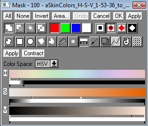

Part 1: Creating the SkinColor HSV-H,S mask.
(1) Click the reference image and open the Mask Tool - Color Range feature.
(2) Left click near the left edge of the reference image and left click Mask Tool 'Contract'.
(3) Left Click - Hold - Shift near the left edge of the reference image; Drag to near the right edge of the reference image; and Release. The Mask Tool should resemble this:

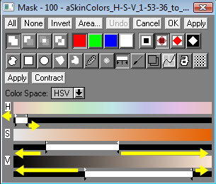

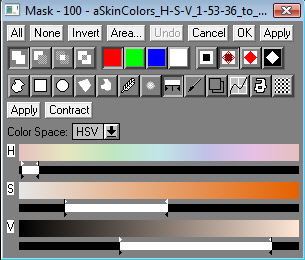

(4) Move the white and black sliders of the H, S, and V color bars as indicated:
(5) The final adjusted ColorRange should look like this: where the 0 to 7% Hues have a slight feather; the Saturation range is feathered to 0 and 100%; and the full 0 to 100% Values for the Hue and Saturation ranges are selected. This means that wherever a Hue and Saturation occurs within the selected range at any Value will be masked...
(6) Close the Mask Tool. The ColorRange setting will be remembered for a given PWP session unless another color range is selected.

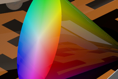

Why protecting SkinColors may be important:
Original image [1:1 crop] to have HSV-S saturation adjustment: http://www.brucelindbloom.com/index.htm ... mages.html...

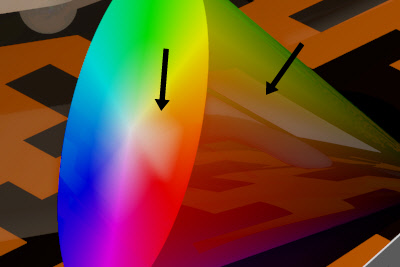

Saturation adjustment with no SkinColors protection: HSV Saturation transform; Black/White sliders at +30%; Preserve: Low & High...
Saturation adjustment with SkinColors protection: Notice the addition of a protected zone [Black slider = +30%; White slider = 0%] of the cone's H,S plane [red-orange hues] and the retention of detail in its side reflection...

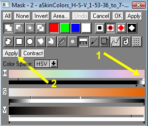

Substitute for the previously suggested Part 2(2) the following...
Part 2(2) Ammended
(2) Open the Mask Tool - Color Range feature. The settings of Part 1(5) should appear.
...(a) Click lower-left Apply Add; creating an 'active' mask on the image.
...(b) Move the H color bar's right white slider all the way to the right.
...(c) Move the H color bar's left white slider to the right to near the right white slider.
...(d) Move the H color bar's left black slider to the left approximately the same as the right black slider adjustment of Part 1(4).
...(e) Move the left white slider to the right so that it overlaps the right slider.
...(f) lower-left Apply Add; adding the Red to Magenta gradient to the Part 2(2)(a) 'active' mask.
...(g) Update the mask to include any additional SkinColors or image areas to be masked. [REMEMBER: the settings of the ColorRange feature of the Mask Tool have been changed. If another image is to be processed, re-set the ColorRange by returning to Part 1(1) of the suggested workflow after completing adjustments for the current image.]
...End of Part 2(2) Ammended... ...continue with Part 2(3)...

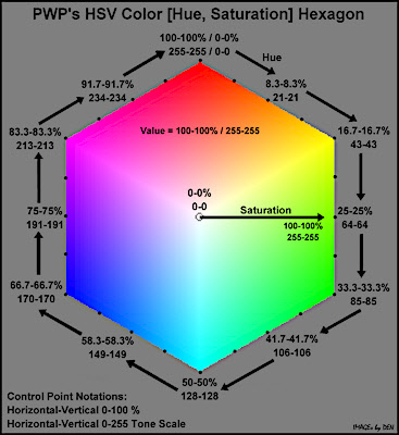

The following might be a useful reference for understanding the PWP Color Hexagon and various notations used to identify hues and saturations as gray tone percentages or the 0 to 255 range:

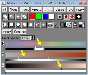

Re: Vibrance vs. Saturation and PWP's Saturation transform
Is a color/tone in the selected protection range? ...A simple way to determine this is to 'Shift - left Click' on the color in the image and note where the black 'tick' contracting marks are in the Mask Tool's Color Range feature. If the 'tick' is inside the white sliders, the color is included. If not, move the appropriate white slider(s) for the H, S, and V color bars so that it is... ...and perhaps re-adjusting the black slider feathering if needed...
