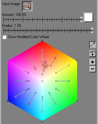

Just experimenting... ...I created a ColorCorrect hexagon where the R, G, B, C, M, Y hues' and their mid-hues' 40% saturations were increased to 80% [actually the Red and Orange hue saturation change is 50->80%], then added blocking skin color control points from a skin swatch pallette...
The skin color swatches:
The ColorCorrect hexagon with protected skin colors [hues, saturations]:
Using the above on a couple of trial images seemed to provide effective results and yes the saturation change is not applied uniformly in a strict sense but seems to go un-noticed when using photo-realistic images... ...skin colors are protected and the saturation change does not increase existing High saturations [90->100% saturations] that would potentially lead to R,G,B channel clipping and loss of detail.

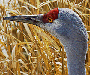

Substituting for a portrait example with skin colors as there is a reluctance to post recognizable people images... ...the following Sandhill Crane image with dried grass in the background might suffice...
The original image:
The original image with the proposed ColorCorrect-ion at 100% Amount and no skin color protection:

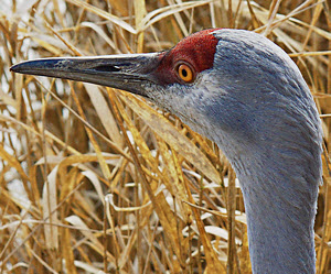

The original image with the proposed ColorCorrect-ion at 100% Amount with skin color protection:
The proposed saturation changes with skin color and High saturation protection are intended to be subtle.

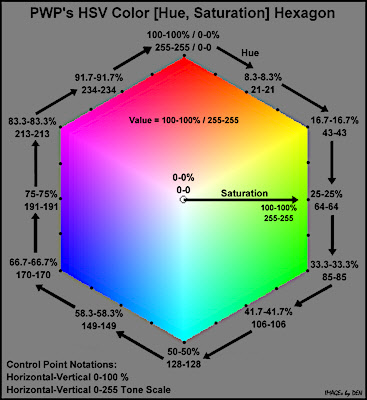

Something that might a useful reference for understanding terms/nomenclature for PWP's HSV Color Hexagon which is used frequently through out the program, might be:
