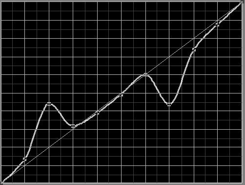

Attached are two snips from Monitor/Printer Curves tool.. Both have 'dips' that I assume should trigger the error message, but only one does.
I'll keep playing around.
John P
John P
- printer curve triggers error message
- error.JPG (44.11 KiB) Viewed 13012 times
- printer curve does not trigger error
- no_error.JPG (41.4 KiB) Viewed 13012 times

The top curve is monotonic, the bottom one is not. To be non-monotonic there must be parts of the curve that are local maxima or minima where the curve is horizontal which is what I meant by peaks or valleys. Monotone increasing means each value is greater than the one before it. Monotone decreasing means each value is less than the one before it. Either type has an inverse, but non-monotonic curves do not.
