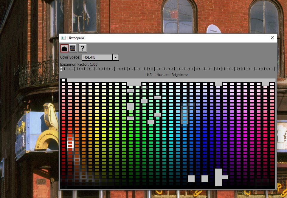

All of the histogram enhancements are interesting. I'm wondering if you would explain the 'blocks' in the -HB versions? (see attached) some are solid and some are framed, and I'm not sure what they signify. Thank you.

The all-gray patches correspond to colors that do not occur in the input image. The brightness of the area surrounding each color patch is proportional to the number of pixels with that combination of brightness and hue. Increasing the Expansion should make it easier to see what is going on since the orange from the brick is so common that is is depressing the rest of the histogram.

Thank you for the clarification.
