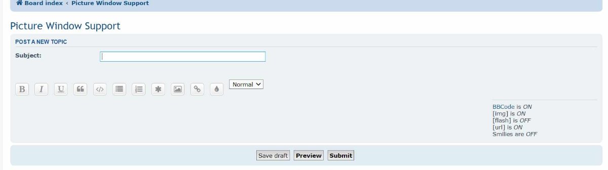

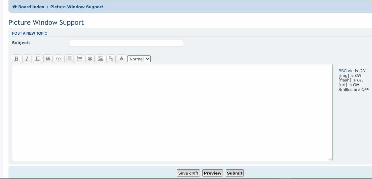

I'm having trouble with the PWP phpBB board in Chrome. The text edit box is not displayed in Chrome (updated) no matter what I do. I resorted to write this message in Edge, which displays is. I haven't had this problem with Chrome until recently - I'm not sure how to diagnose or solve it.
Chrome
Chrome
Edge
Edge

I keep fighting with this Chrome curse, and it seems that if I change the account which has no extensions installed, everything works as it did before. So my conclusion is that its one of the extensions that interferes with the phpBB. How do I find which one - turning them on and off one by one? Is there a way to diagnose it in some other way? Thanks!
Re: Chrome and phpBB
Turning off extensions an Chrome applications didn't quite work either. An interesting part is that the same thing happen on two computers, on each of the two accounts that I'm using, but only when I log into the accounts (and thereby synchronize the extensions, or so I think).
For the record, I think I finally found it: it was Chrome browser extension "GPS Coordinates for Google Maps" that was messing things up...
