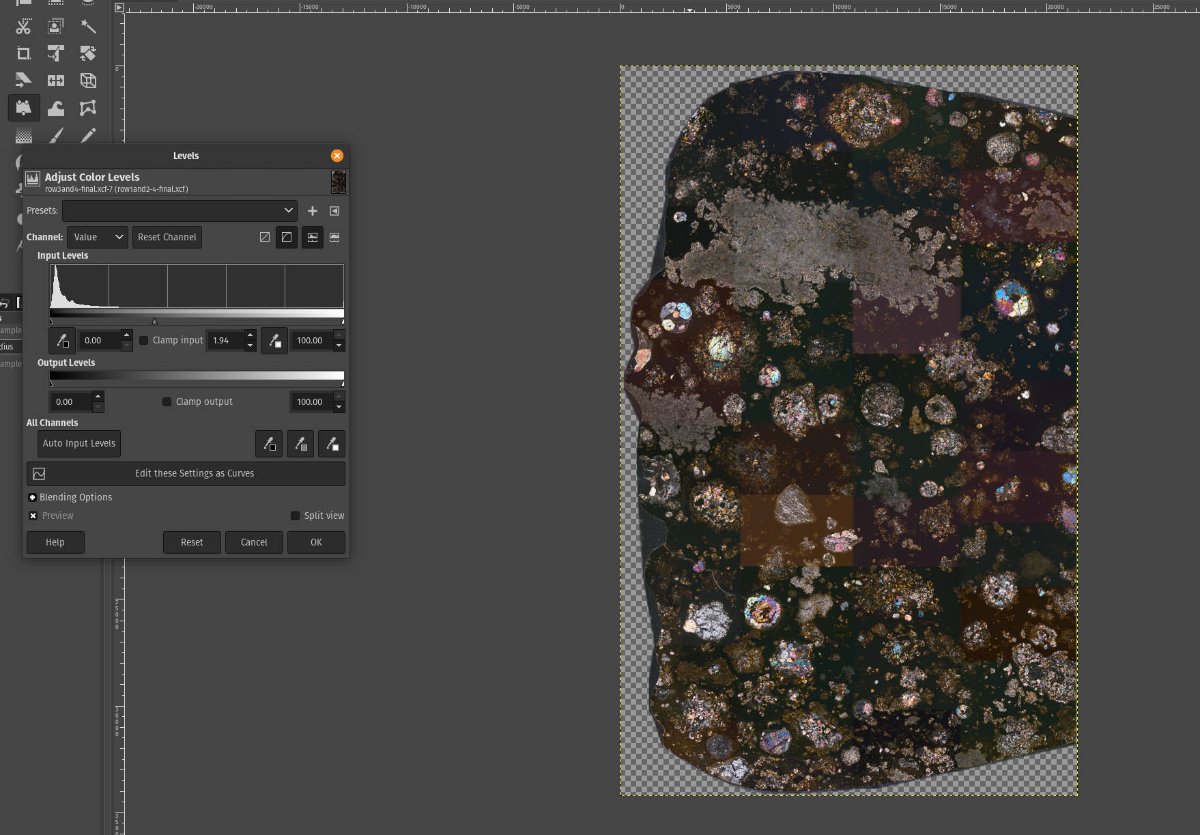

Thanks jsachs for your reply. For the images they are taken under a manual exposure, identical settings and exposures for each. They are then focus stacked with Zerene Stacker. It might be the case that Zerene Stacker could be issue.
Attached a screenshot showing the issue (the difference has been exaggerated). Some individual image squares can been seen.

My recommendation is to do as little to the image files before stitching as possible. First make sure your raw converter is not making any automatic exposure adjustments. If you are working from JPEGs, that could be the problem as they are processed in-camera and there may be variations in the processing among the images. As long as you used the same lighting and camera settings, the stitch should not show brightness variations. Also consider stitching before focus stacking. Only when all that has been done, open the image in Picture Window and start making adjustments.
