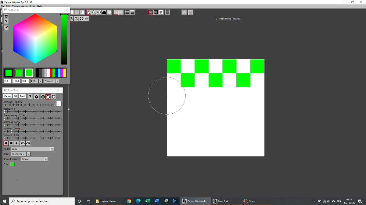

Paint tool snaps to bottom left of pixel;should have an option to snap on pixel center
Posts: 744
The paint tool snaps to bottom left of pixel.
It is difficult to use at high magnification.
The paint tool should have an option to snap on pixel center, or snap on pixel center by default.
2021-02-26 PWP8 paint tool snaps to bottom left of pixel;should have an option to snap on pixel center.png
2021-02-26 PWP8 paint tool snaps to bottom left of pixel;should have an option to snap on pixel center.png (111.83 KiB) Viewed 2075 times

Hi Jonathan !
Thanks for implementing this fix ... very impressed by the speed of resolution.
Pierre
