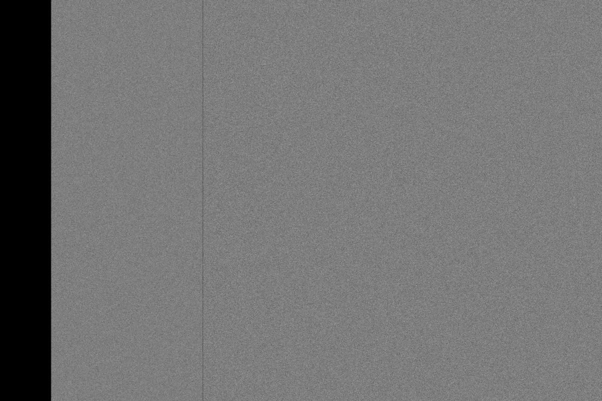

Attached is a self-contained workspace (no external image files needed) that illustrates a problem with the Warp transformation.
When using the Warp Transformation, there is an anomaly on the opposite edge of the warped file. See here the seam that appears when compositing the warped image onto another image:
Also, the problems reported on Nov 3, 2020 (where the Warp Transformation changes the size of the image by default) still seems to be a problem with larger images - the Nov 3 example only used an 800 pixel wide image but for larger images the resizing problem still occurs.
BTW, an image warp and composite (as illustrated here) shows no seam in PWP 7.

It appears than when you did the warp, you accidentally moved the right edge very slightly beyond the edge of the image and thus picked up a thin vertical black line along the right edge. This was then composited onto the base image. If I go back to the Warp transformation and do a Reset and then move just the left edge of the grid, the line goes away.

I don't see that being the case. I can send you a screen-shot video if that would help. Also, notice that the Warp transformation changes the Y dimension from 2000 to 2001 on its own.

There appear to be various roundoff issues that can create small variations in the location of the quadrilateral overlay. I was able to fix the error in the output image size when everything is reset -- at least for the case you posted.
Generally, Warp is not intended to be used the way you are using it -- it is really for doing perspective correction and intentionally distorting images. If all you want to do is add a black border to one side of an image, I would use Add Border.
Here is how Warp currently works:
Before you drag part of the quadrilateral, the current vertices are converted to screen coordinates -- after dragging the quadrilateral on the screen, the coordinates are converted back to image coordinates. If the zoom factor is less than 1:1 (i.e. if the image is zoomed out), this can cause small changes to the position of the quadrilateral, even parts you did not move -- the advantage of this technique is that if the zoom factor is greater than 1:1, you can set the vertices with sub-pixel accuracy. None of this really matters in most cases when you are straightening the verticals in an image, but it does not maintain absolute precision of vertices that you do not explicitly move.
