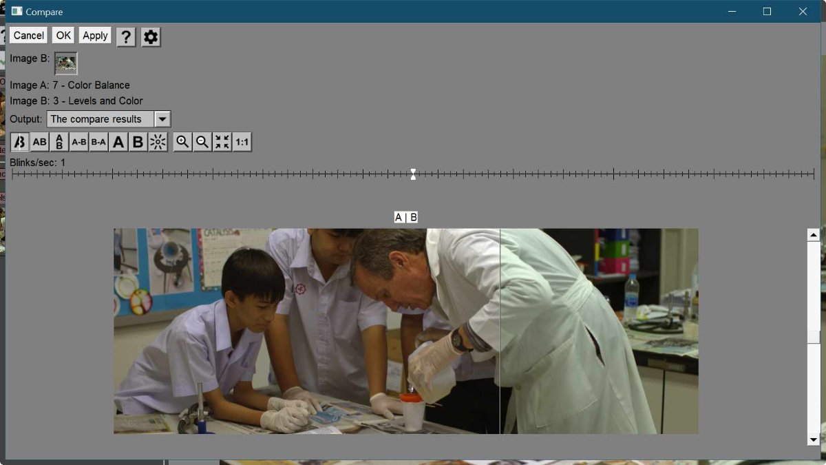

There are not that much different, but just to show what I'm seeing here is the Compare screenshot of Colour Balance vs. Levels and Colour at default settings. I kind of like what Colour Balance is doing more than the Levels and Colour. The image has plenty of 'white' to anchor on.

Re: Auto WB in Color Balance vs. Levels and Color
To get auto white balance to brighten the image in Levels and Color you need to auto white balance and auto expand the dynamic range. I don't set this as the default since it would apply every time you started a new image or edited an existing one.

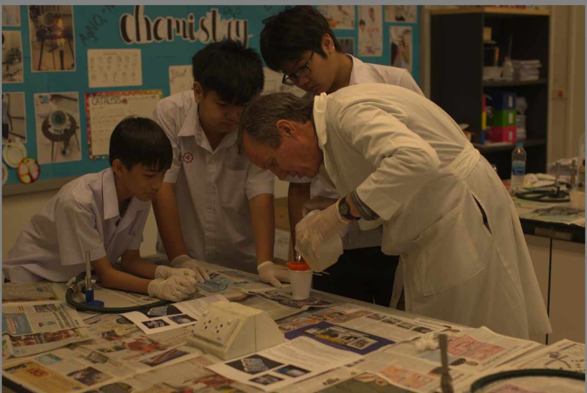

Yes, I think I did set both in Levels and Colours - it's the tint that auto-corrections get better in Colour Balance, I think. The original image is difficult to auto-correct, to begin with - mixed-light RAW without WB corrections.
