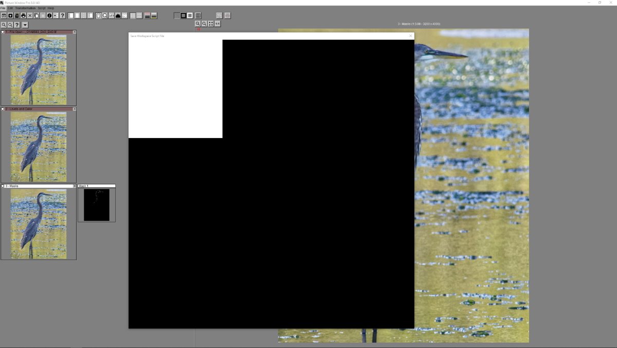

Creating a mask with many paint strokes causes the masking transform to freeze. It also prevents the workspace from being saved normally (see image).
I checked system memory usage and 3/4ish of 32gig memory was free. Attached is the zipped offending workspace file.

I can load the workspace here and run it on a test image OK. What size and type was the original image?

3200x4000 48-bit color
Rev 8.0.141 seems to work fine.

I didn't change anything since 141 that should have any effect -- probably this does not happen every time. Or does it consistently fail on 143?

It failed on a similar image edit yesterday and I had to go back 141 to finish it. I reloaded 143 this morning to see if I could reproduce the problem (which I did and sent to you). I'm finishing this edit w/o a hitch on 141 now. I've attached the workspace from yesterday (3000 pix max dim). Try to re-open the mask transformation and add many additional paint strokes. The transformations stops working and all the window buttons go away.

I am seeing that 143 is much slower than 141 for some reason and I also found a minor resource leak which I have fixed. Will try to figure out what is slowing it down.
... turns out the speed difference was between the debug and release versions, so not an issue. Will post a new version shortly with the resource leak fixed for you to try.

Looks good. I did not see the problem on 144 while performing a similar edit on a similar image this morning.
