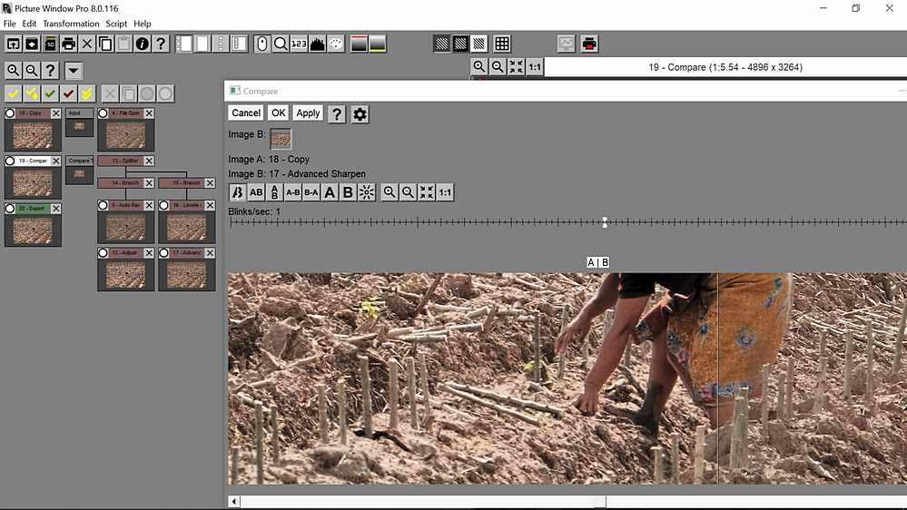

I figured I would illustrate the idea of using Compare in a separate new top-level branch as a tool.
The left-most top-level branch consists of Copy + Compare + (optionally) Export. It can compare any two images in the browser without the Compare's output having any consequences on the output of the actual processing branches.
The optional Export in the end (not necessary for comparing alone) can be used to make a decision which of the two images are worth saving (you press either A or B) before exporting/saving one of the processed images as a file. Useful in a batch but also as a stand-alone.
