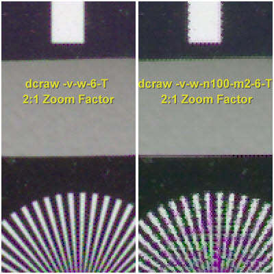

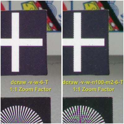

I am not so sure even when 'dcraw' supports the X20 that 3rd party software will have sufficient desire to invest in development alogrithims for this non-traditional sensor array as even 'dcraw' seems to have difficulty when traditional wavelet noise reduction [-n 100] and 3x3 median bluring [-m 2] are applied...
Illustrations...
A DPReview X Pro-1 test image RAF file converted with dcraw v9.17 with minimal options: -v [messages]; -w [camera white balance]; -6 -T [output a 16 bit tiff]...
Image area zoomed 1:1: left, base conversion and right, base conversion with added luma/chroma noise reduction...
bDSCF2008_1-1 Zoom Factor.jpg (47.66 KiB) Viewed 52756 times
Image area zoomed 2:1: left, base conversion and right, base conversion with added luma/chroma noise reduction...
cDSCF2008_2-1 Zoom Factor.jpg (47.06 KiB) Viewed 52743 times
Note particularly the visual element edges and the apparent difference in camera white balance color casts...

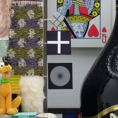

Jonathan, Kiril... perhaps you would consider having PWP support the Extract-ion of the 'embedded' JPEG's of RAF raw files for Fuji cameras with X-Trans sensors... ...and later, providing the raw conversion development...
Illustration...
A 400x400 1:1 zoom factor image area of the 1920x1280 embedded JPEG [DSCF2008.RAF (full size = 4952x3288)] previously illustrated...
DSCF2008.thumb-1920x1280_400x400 1-1 image area.jpg (47.91 KiB) Viewed 52545 times
Obviously, camera settings for a full sized JPEG, [perhaps similar to Canon's EOS-350D "RAW+JPEG" setting], are needed and the resolution is limited to 8-bit color depth containing JPEG compression artifacts... ...the in-camera resulting conversion is really not all that bad if the scene is captured with good exposure...

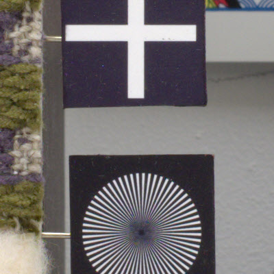

DCoffin's dcraw v9.18 and v9.19 has "3-Pass X-Trans interpolation" that does a creditable interpolation of the X-Trans sensors... ...comes with a price... ...it took 2 minutes to convert to tiff the Fuji X-Pro 1 DSCF2008.RAF file with options: -v -w -6 -T...
Should see more 3rd party software appearing perhaps with multi-threading...
dcraw v9.19 supports the X20...

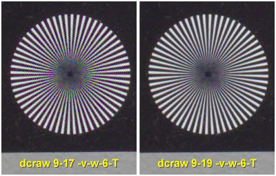

...Update for a Windows dcraw.exe, version 9.19...
Sebastian Nibisz has made available today a dcraw9.19 windows update for SNS-HDR linked here:
http://www.sns-hdr.com/forum/viewtopic. ... 2974#p2974
This compile will execute in 30 seconds vs. 2 minutes for the previously linked dcraw9.19 files... ...and can be used to update the dcraw.exe file in the SNS-HDR program folder(s) if you have the SNS-HDR program...
The following illustration compares the dcraw conversions of an 1:1 image area of the X-Pro 1 RAF file...

If of interest and you would like to 'pixel peek' the difference between a DCRAW9.17 "Bilinear/VNG interpolation" and a DCRAW9.19 "3-pass X-Trans interpolation" with Mouse On/Off comparisons for a Fuji X-Pro1 dcraw converted camera raw file...
... you are welcomed to visit: http://www.ncplus.net/~birchbay/tutoria ... /index.htm ...
