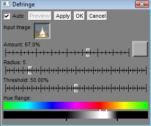

I have not fully investigated the impact of the following suggested Defringe transform settings on the full image that you have provided to me...
Suggested DeFringe Settings.jpg (35.47 KiB) Viewed 51829 times
...but when applied to your posted "IMG_2115_BloomingCrop" image results in the following:
which has greatly reduced 'blooming', especially when followed with a medium radius Local Contrast Enhancement that is biased towards the dark half of edge contrasts...

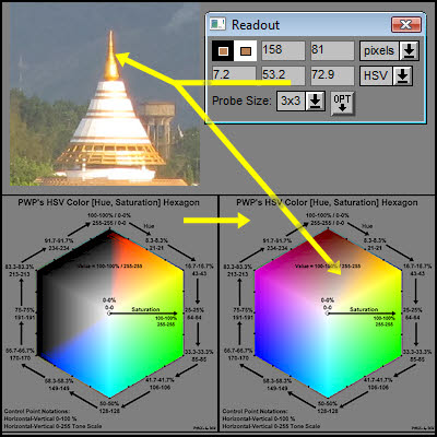

The following color hexagon illustration indicates the reasoning/analysis for the suggested Defringe transform settings...
The 'bloom' has a 7.2% Hue and a 53.2% Saturation in the HSV color space model... ...the Defringe default Hue and Saturation range is roughly 67 to 100% Hues with 0 to 100% Saturations [shown bottom left]. The transform's Hue sliders were moved to a narrow Hue range that included the image's probed 7.2% Hue/53.2% Saturation 'bloom' with the blending sliders/Radius/Threshold/Amount adjusted to a preference for the needed 'bloom' reduction [shown bottom right]...
Defringe Range shift.jpg (47.89 KiB) Viewed 51791 times
...in this manner with the aid of the Readout Tool and a reference color hexagon, one can select preference Defringe transform Hue ranges that differ from the 'default'... ...just use a reference color hexagon image as the initial transform Input image, set the Hue sliders, then change the Input to the 'bloom'-ed image to adjust the remaining settings...
