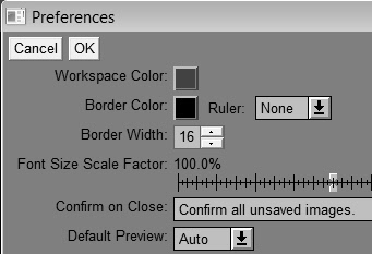

Re: UI fonts mushy on 30" screen
Posted: May 1st, 2013, 3:22 pm
Here's how it looks on my Dell 23" monitor.
