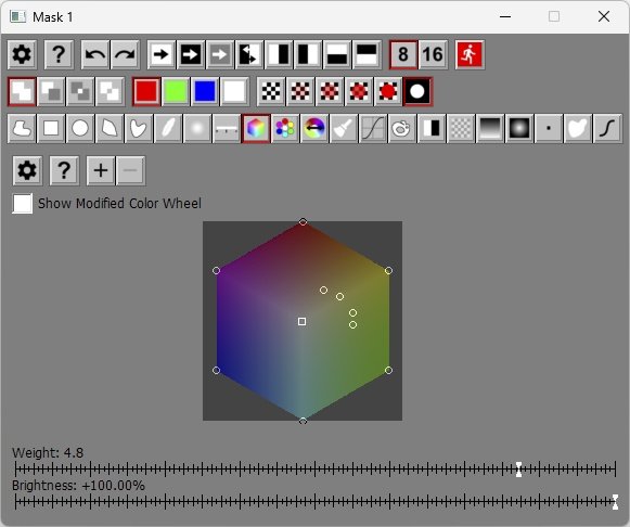

I was able to get an imperfect but possibly useful mask.
I built the mask in two stages -- first using the Hue Saturation mask tool and setting a high brightness and weight on the white control point in the center and adding a few other control points with 0 brightness to remove the orange, yellow and green parts.

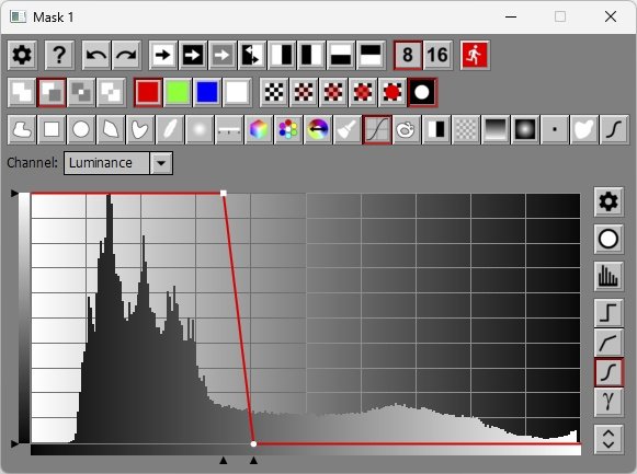

Then I used a Brightness Curve mask tool in Subtract mode to remove the darker parts of the previous mask.

For the next release, I added extra controls to the Hue Saturation mask tool so you can create the mask in a single step instead of having to apply a Brightness Curve mask tool after the Hue Saturation tool.

J. I have tried this technique but am not sure I am doing it right.
When I open the Color Wheel I get the six circles.
What I have been doing is click on my preview image in spots that seem to have the color I want to mask.
Each time I do that I get a square. When I click on a nearby point in the image I get a new square and the previous square goes round.
Am I supposed to do a normal click or another type of click?
I guess that to finish I need to turn the circle at the centre back to a square.
This is where I get stuck as the Help refers to a filled square and mine don't seem to fill.
Your guidance please.
Re: Masking technique sugestions???
Posted: May 16th, 2025, 6:25 am
Each control point has a Weight and Brightness slider. The current control point is displayed with a square and its weight and brightness settings are displayed in the sliders.
To include a color in the mask, set its control point's Brightness to a high value. To include more colors around the control point, increase the Weight. To exclude a color, set its control point's Brightness to zero.
