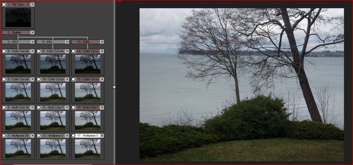

My initial S22 linear DNG file conversion workflow [sRGB working/display color space and 2.20 gamma]:
1. Convert the DNG file to your working and display color space (sRGB);
2. Linearly expand to white (255) and black (0) points;
3. Apply an Inverse 2.20 gamma curve;
4. Correct white/black points for color balance; and
5. Lightly sharpen for small, medium, and large detail.
Attached is a workspace script (in ".txt" format for posting) for the above steps in the HSV, HSL, and RGB color spaces.
The resulting image(s) is/are suitable for further tone/color mapping according image content and artistic preferences.
The images are somewhat flatt but contain all available file tone/color/detail.
Mostly I will use the resulting RGB image for my preference tone/color mapping to the final image.

It has been too long since I've edited a script to know what is specific to my files/system so I will post pictures of the RGB branch from which it is simple to form your own script.

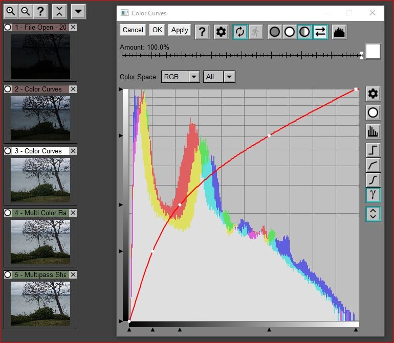

Step 1. An Expanded histogram RGB-All Color Curves transform in which the upper right control point is moved left to the histogram edge and if necessary the bottom point is moved to the right.
Step 1 RGB-All Expanded Histogram.JPG (86.67 KiB) Viewed 189519 times
Step 2. An Inverse 2.20 gamma brightening curve is applied using an RGB-All Color Curves transform.
Step 2 RGB-All Inverse 2.20 Gamma Curve Expanded Histogram.JPG (88.9 KiB) Viewed 189519 times

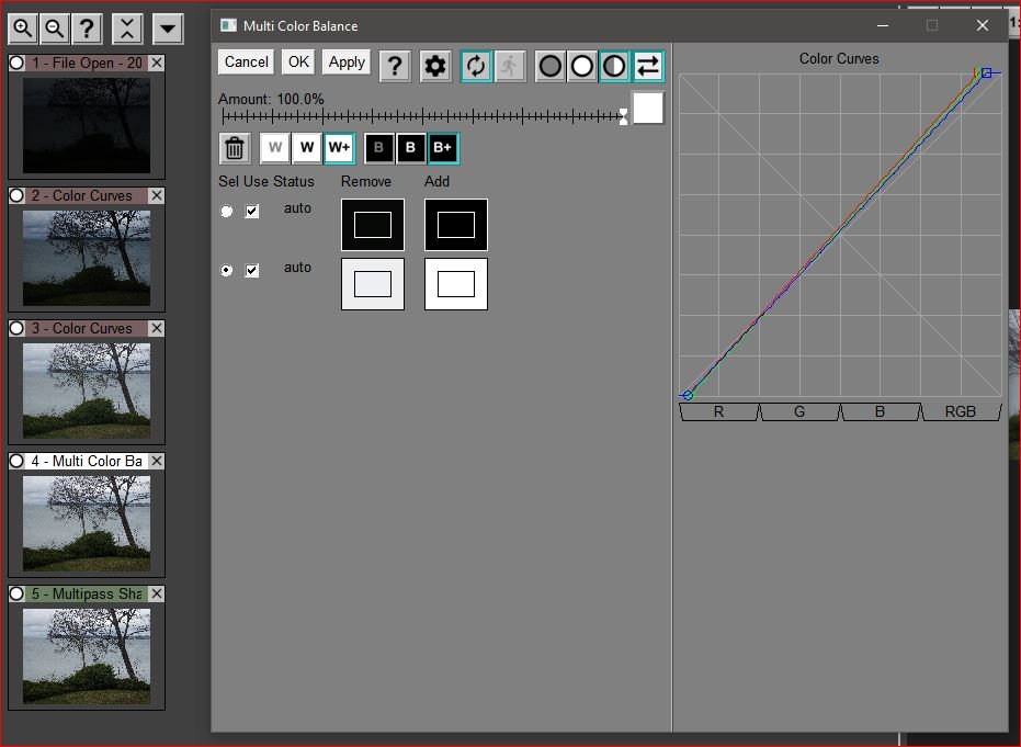

Step 3. The black/white point color casts are removed using the Multi-Color Balance transform.
Step 3 Remove Black-White points color cast.JPG (82.99 KiB) Viewed 189519 times

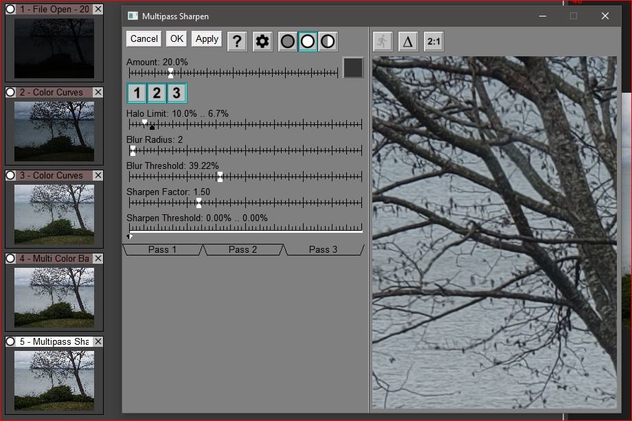

Step 4. Light sharpening is applied using the Multi-Sharpening transform with Pass 1, R=50; Pass 2, R=5; and Pass 3, R=2.
Step 4 Sharpen Pass1 R=50 Pass2 R=5 Pass3 R=2.JPG (121.98 KiB) Viewed 189519 times

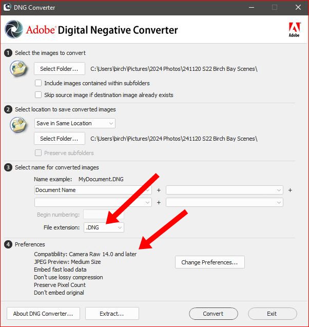

I recently upgraded to Expert Raw v3.0.08.10 for my Galaxy S22 camera phone and PWP8 will no longer open the linear *.dng file and produces an error message: "Error reading file: C:\... \...\20241002_112201.dng".
Also, the linear *.dng file cannot be read by Raw Therapee v5.11 or Dark Table v4.8.1.
A work around is using Adobe DNG Converter v17.0, changing the Preferences/Compability to "Camera Raw 14.0 and later".
So that the converted file is recognizable, change "File extension:" to " .DNG" if it is to be saved in the same folder as the original.
This seems to be a Samsung\Windows related problem awaiting resolution...
Have fun... ...den...
