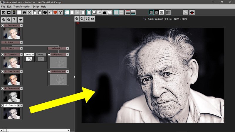

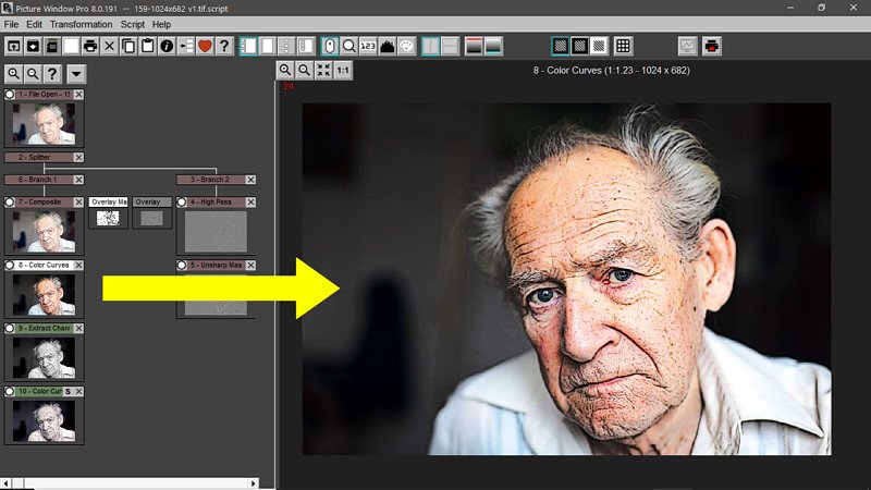

I encapsulated Den's technique and a copy of the original image in the attached script file. To run the script, just do a Script/Open Script command and select the script file. It will then ask you for the name of an image file to operate on -- once you pick a file it will open it and create the Lazlo effect on it.

The Lazlo Effect is really a variation based on the post imaging style of Dragan. An internet search for the Dragan Effect will produce links to many tutorials which have differing workflows that can provide ideas for your own style. For an example:
Creating the Dragan Effect -- https://support.corel.com/hc/en-us/arti ... ntShop-Pro
A basic PWP8 variation for the image example of the tutorial follows: HSL-SL Color/Tone adjustment of a HighPass/USM sharpened image version; and converting to SplitTone monochrome...
HSL-SL version.jpg (78.07 KiB) Viewed 51571 times
SplitTone version.jpg (78.17 KiB) Viewed 51571 times
The PWP8 script with a Copy starting dialog is attached.
Have fun exploring... ...this technique is not just for portraits but with variations works well for landscape and nature images as well.
