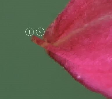

Another Run Away Clone Tool Event - 21Jun2019 Rel.
Posted: June 22nd, 2019, 8:29 am
by jfoster
Seems to correspond to fast repeated tool use.
Re: Another Run Away Clone Tool Event - 21Jun2019 Rel.
Posted: June 22nd, 2019, 4:30 pm
by jfoster
I made a screen capture video of this problem. Too big to post. Can email a link if that would be helpful.
From stepping through the video, I think this is what's happening: when a clone tool stroke finishes, and the mouse button is released, the screen updates (and the title bar of the image momentarily blinks gray). If another clone tool stroke begins during this update time, the problem seems to occur.
