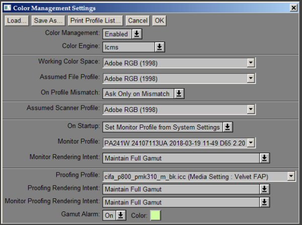

For what it may be worth, below are the settings I use for a NEC PA series monitor. The monitor stores its calibrations in an internal lookup table rather than in the graphics card of the computer, so if the BenQ does the same, the settings are worth a try. I calibrate the monitor to Adobe RGB color space (for PWP work; I toggle to an sRGB calibration for Web surfing and ordinary office tasks).
