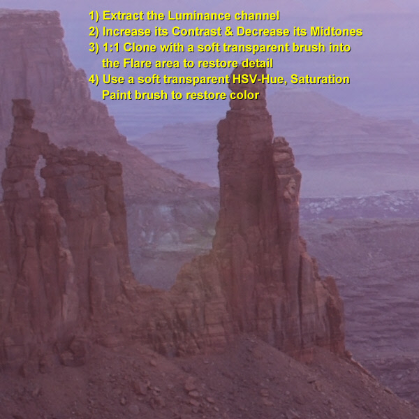

This post should have the example (if I've done everything correctly this time.
One of the problems I had in trying to remove it was the difference in texture/tone/colour, most pronounced as the flare extends beyond the edge of the "tower" and into the background landscape.

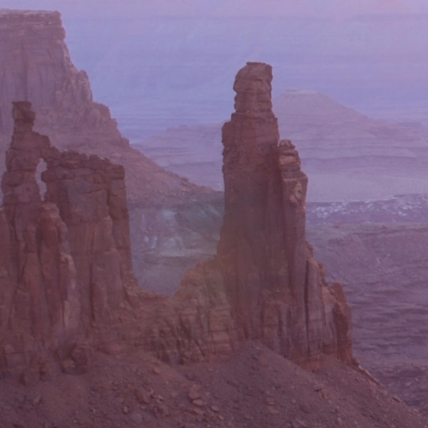

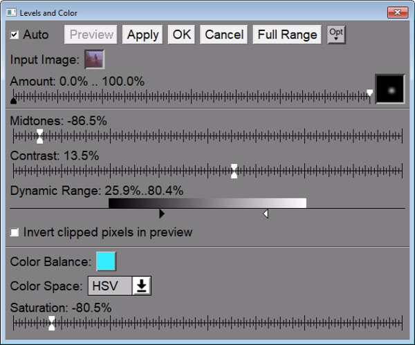

The quickest way I know of to deal with this is to first make a soft mask that covers the lens flare area and then use it with the Levels and Color transformation. I set the color balance to a cyan to counteract the excess red and dropped the brightness and saturation for the masked area.
If you want you can use the same mask to add a little contrast or sharpness as well.
Levels and Color
Levels and Color
Lens Flare.jpg (146.88 KiB) Viewed 11999 times
Result
Result
Lens Flare 1.jpg (175.1 KiB) Viewed 11999 times

Another approach could be to use soft-transparent Clone and Paint brushes [Softness = 90; Transparency = 90; Radius = as needed]... ...Stamping [click-move-click-move,etc] rather than Painting [click-hold-drag-release]...
...probably more easily done for the small posted image rather than the full sized one!

I created a circular mask over the lens flare and then used the mask blur tool to soften the edges a lot. Since the mask was red and the lens flare was red, it looks about the same.

The idea is to match the lens flare - if the edge is sharp, the mask should be sharp - in this case the edge was soft. I don't remember exactly the value I used.

One of the reasons I prefer to use Brush tools while somewhat manually intensive and requires some practice is that mask edges as indicated are limited to uniform transition gradients that may not always match all the Flare gradients as they are not uniform... ...stamping with a soft-transparent brush will allow differing change accumulations as needed to best match the non-uniform Flare image areas and its edges...
Also the amount of Mask blur will be dependent upon image size... ...a good soft mask edge transition gradient for a 600x600 pixel image will not necessarily work well for the full sized image.

Thanks to Jonathan and Den for their instructive replies. I learned a lot from both.
I think the trickiest part was getting the right colour (for the Colour Balance in Jonathan's process and the Paint Brush Tool in Den's process), particularly where the flare bleeds across the edge of the tower into the background, which is a bit different colour.
